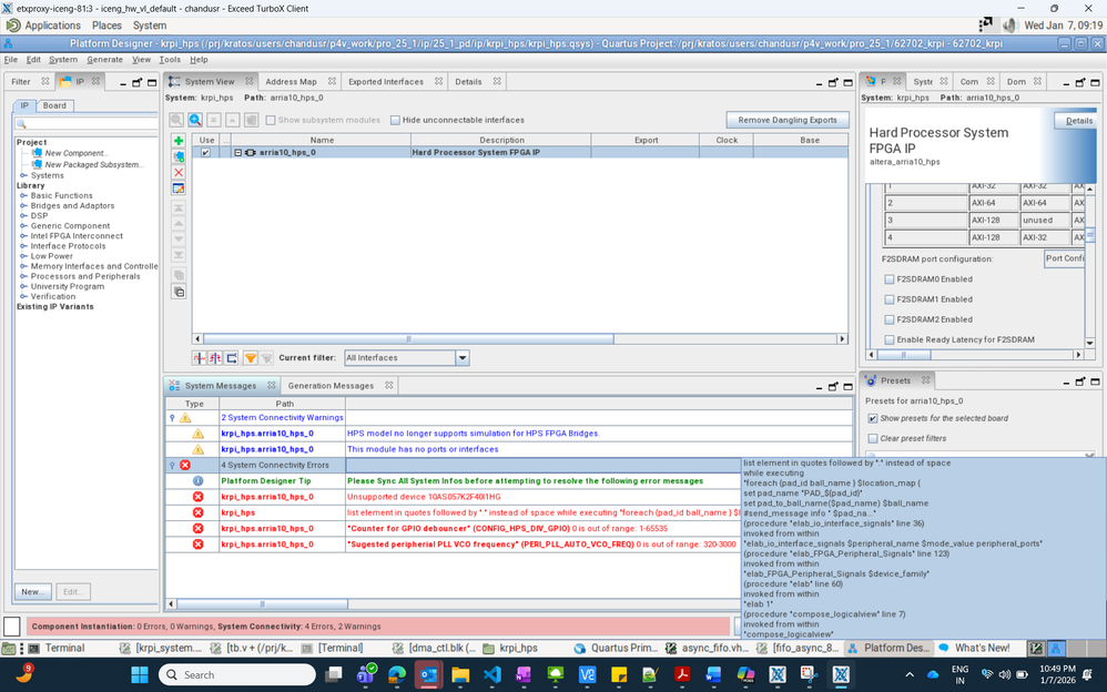

9 months agoQuartus 20.1std compilation fails for Quartus map - Device 10AS057K2F40I1SG
Hi Chandu sri,
We will continue the discussion here.
Issue Chandu Sri is facing compilation errors in Quartus when working with the Arria 10 device (10AS057K2F40I1SG/10AS057K2F40I1HG) and HPS I...

8 months agoYes, this error occurs in Platform designer when creating HPS IP core

8 months agoI suspect that you are not adding the HPS IP or making the connections correctly.
Please refer to the GHRD design I shared to understand how to connect the HPS IP.
Alternatively, try removing and re-adding the HPS IP in the top.qsys file.

I have taken your .qar file and it seems like the device you are using is different. I tried to change the device at my end and regenerate the Qsys_top, but, it got stuck and I am unable to regenerate.
Could you try with device number 10AS057K2F40I1HG and check if you are able to generate the Qsys.
