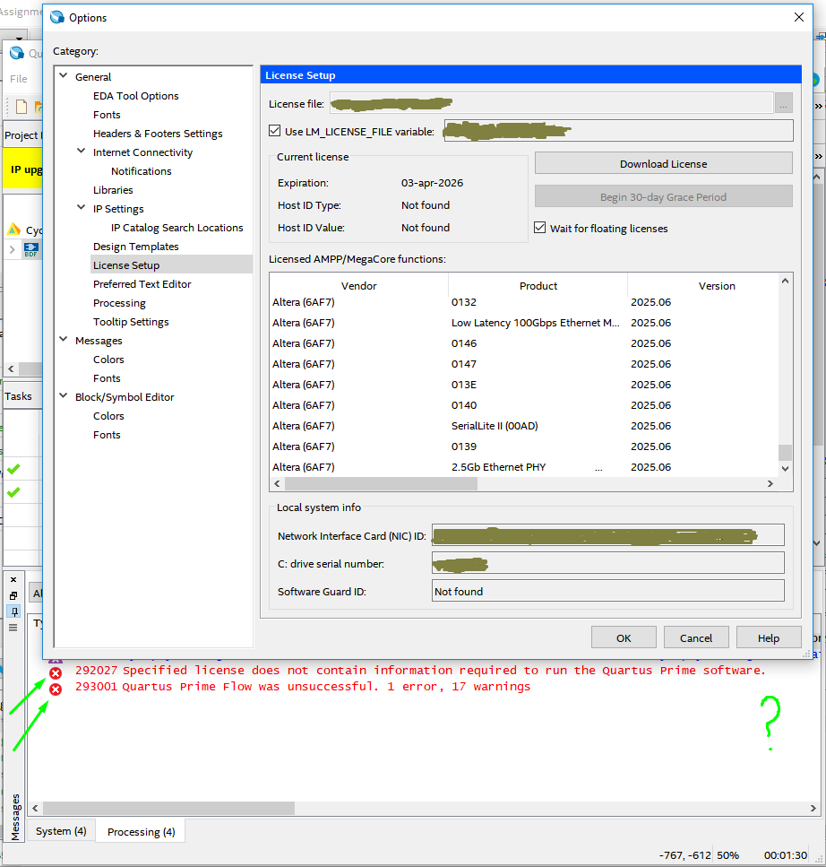

I have an issue with Quartus 20.1 software licensing.
The same project in Quartus 18.0 compiles successfully.
I checked from the Self Service Licensing Center that license file contains no expired IP cores and tools.

To narrow down the issue. Can you provide information on your?
1) Debug/error.log file
2) License.dat file
3) Error message screenshot
4) Screenshot of Quartus >> tools >> license setup
5) assembler report .asm.rpt file
• The assembler report is located in <Project directory>/Output_files/<project_name>.asm.rpt.
And for privacy, you can reply/attach your file in private message.

Well, the error occurs at the assembler stage. It is worth noting that if I delete all licenses in the license.dat file and leave only server initialization, the error will be similar.
And also, that license file works well with Quartus 18.0, as I said.
