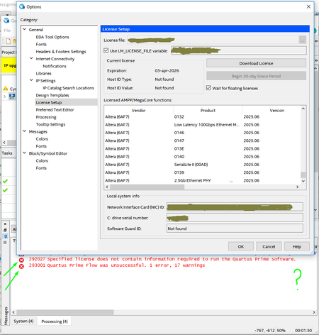

Hi all!
I have an issue with Quartus 20.1 software licensing.
The same project in Quartus 18.0 compiles successfully.
I checked from the Self Service Licensing Center that license fi...

Hello everyone!
In the end, everything worked out, and the problem was resolved.
It is not known for certain whether one or all of them helped.
report .asm.rpt was not generated at all and there was nothing in the error.log.
I did the following:
1. Reinstalled the license daemon from this link https://www.intel.com/content/www/us/en/programmable/support/support-resources/download/licensing/daemons.html
2. Recreated the license file again (it had a lot of duplicates). I left the most recent files in it.
3. Configured the server again using this video https://www.youtube.com/watch?v=llLaWatUbe8 and this troubleshooter helps https://www.intel.com/content/www/us/en/programmable/support/support-resources/knowledge-base/ts-index/lic.html
4. I also configured the firewall again (this turned out to be critical on one of the machines)
Together, these actions helped me to solve the problem. I hope that these actions will help someone else.PS: Thank you for your responsiveness, AR_A_Intel.--
