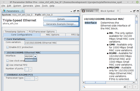

6 years agoQuartus 17.1 with Triple Speed Ethernet IP core 17.1 on Arria 10. RGMII not working and I just found this errata stating the RGMII is not supported, but GMII and SGMII are: FB: 330493. Can anybody confirm?
Here's a link to the errata: https://www.intel.com/content/altera-www/global/en_us/index/support/support-resources/knowledge-base/ip/2017/does-the-triple-speed-ethernet-ip-core-support-rgmii-mode...
