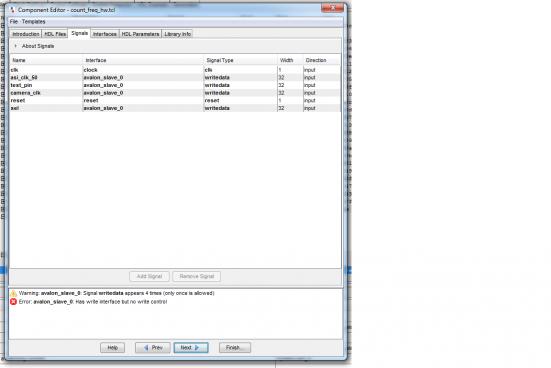

Hi , I am trying to create a new component on Qsys , using my verilog code. The problem is that after I select the interfaces and the kind of signals , an error :"Has written interfaces but not write control" appear on component editor, and I don`t know how to fix it.
Anyone has some idea?
http://www.alteraforum.com/forum/attachment.php?attachmentid=11113&stc=1

    you have set asi_clk_50, test_pin, camera_clk and sel to avalon_slave_0 which is an altera defined interface for memory mapped components, see:
    https://www.altera.com/content/dam/altera-www/global/en_us/pdfs/literature/manual/mnl_avalon_spec.pdf
    and as such has to obey the format defined in the document. you have set the signal type to writedata for 4 of the inputs and only 1 writedata is used in an avalon slave interface. hence the warning and a write signal is required with writedata hence your error.
    this doesnt look like what you are trying to achieve. perhaps see the avalon conduit interface? also check the interface tab where you can set it all up using the gui

    Thank you for your reply, I am new with Altera FPGA`s and I am a bit confused...I read something about avalon conduit interface, you are suggesting me that conduits can be used in my system in place of avalon memory mapped interafaces?
  • Altera_Forum's avatar
    Altera_Forum
    a memory mapped interface would be used when you are trying to write data using an avalon bus to a memory location in your component. An example of the type of inputs and outputs for an memory mapped interface would need : clk, reset, address, write, writedata, read, readdata, waitrequest, readdatavalid etc.
    This doesnt look like what you are trying to do. Quote from the pdf i linked:
    "Avalon Conduit interfaces group an arbitrary collection of signals. You can specify any role for conduit
    signals. However, when you connect conduits, the roles and widths must match and the directions must
    be opposite. An Avalon Conduit interface can include input, output, and bidirectional signals. A module
    can have multiple Avalon Conduit interfaces to provide a logical signal grouping. Conduit interfaces can
    declare an associated clock. When connected conduit interfaces are in different clock domains, Qsys
    generates an error message"
    If you just want your signals passed in and out of your component in your own way then perhaps a conduit would be appropriate.
