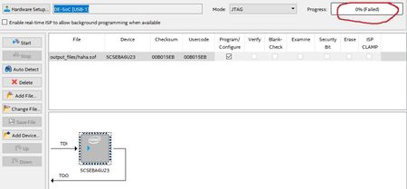

Hi, I'm using a TSom Evaluation Kit with a Cyclone V. Every time I open the Programmer to upload my sof file, I have an device already selected. If I try to upload the configuration, it fails (see...

By right it shouldnt be as the development kit has only 1 cyclone V SoC device. May i know how do you upload the sof?
Can you try to click "auto detect" first to let quartus determine the device available and then only add sof file into it?
