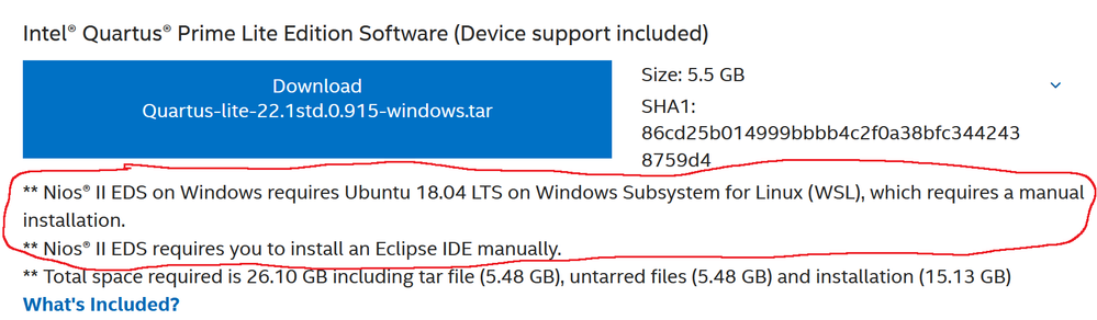

  • song_ha's avatar
    song_ha
    Hi all,
    today I have the same problem. The main reason is that I did not install Ubuntu 18.04 LTS on the Windows subsystem as described in the instructions as below. After I completed the following requirements, everything works fine.
    I used the latest version 22.1.1 of Quartus on Windows 10.
    ** To install Ubuntu 18.04 LTS : https://www.intel.com/content/www/us/en/docs/programmable/683525/21-3/installing-windows-subsystem-for-linux.html
    ** To install Eclipse IDE: https://www.intel.com/content/www/us/en/docs/programmable/683525/21-3/windows-installation.html
