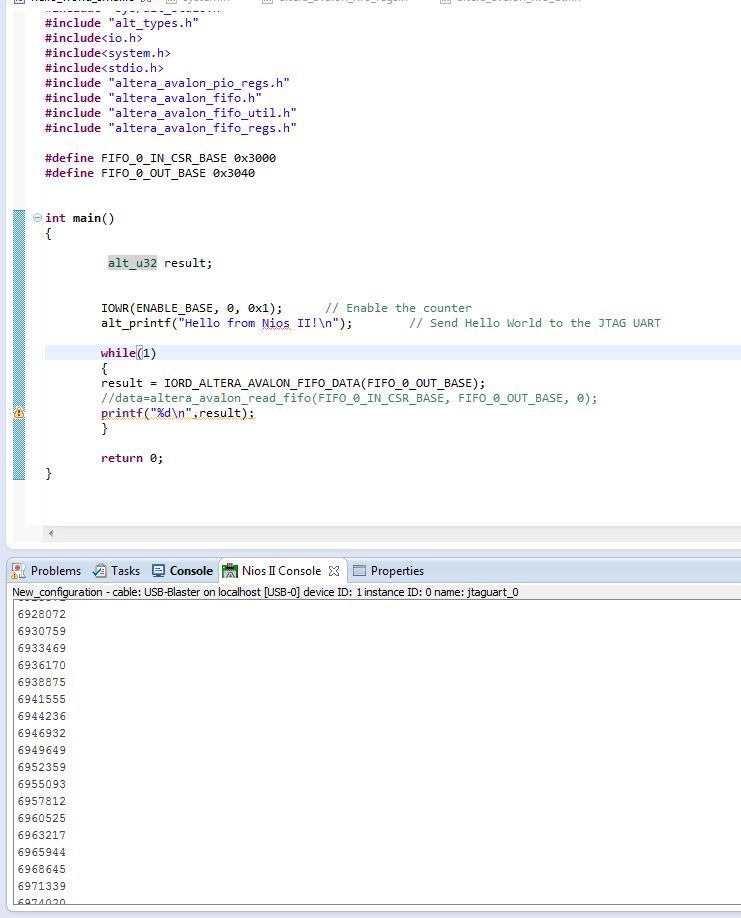

  • SS5's avatar
    SS5
    Again, i am facing the same problem. Data is not in proper sequence in NIOS, i am unable to debug. I am attaching my Block diagram and NIOS code. Please anyone guide.
    For Qsys design, please refer above question.
    Nios Console too attached
