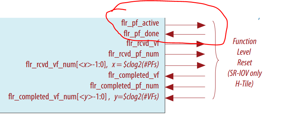

I am trying to do initiate Function Level Reset, on Avlaon streaming pcie hard IP (2PF and 6VFs), using setpci command and if I try to read the device back using lspci command the device is hang with ff as shown below,

The flr_pf_active signal - output from Avalon-Streaming PCIe is also zero after doing FLR.
Please suggest is this correct behavior.
Also help us understand what all factors can contribute to this observation.
