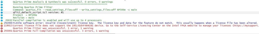

I spoke to soon. I am getting a license error at place and rout. My original error was there was a typo in my NIC. I edited the license file to fix that. Now the license file is recognized by Quartus, I can open a project and complete synthesis, but it fails at place and rout with the following error.

Hello. I was able to re-create a license from the self service center with another NIC on my computer and it seems to be working. I'll get back to you if this is not resolved. Thanks. Fran Turner
