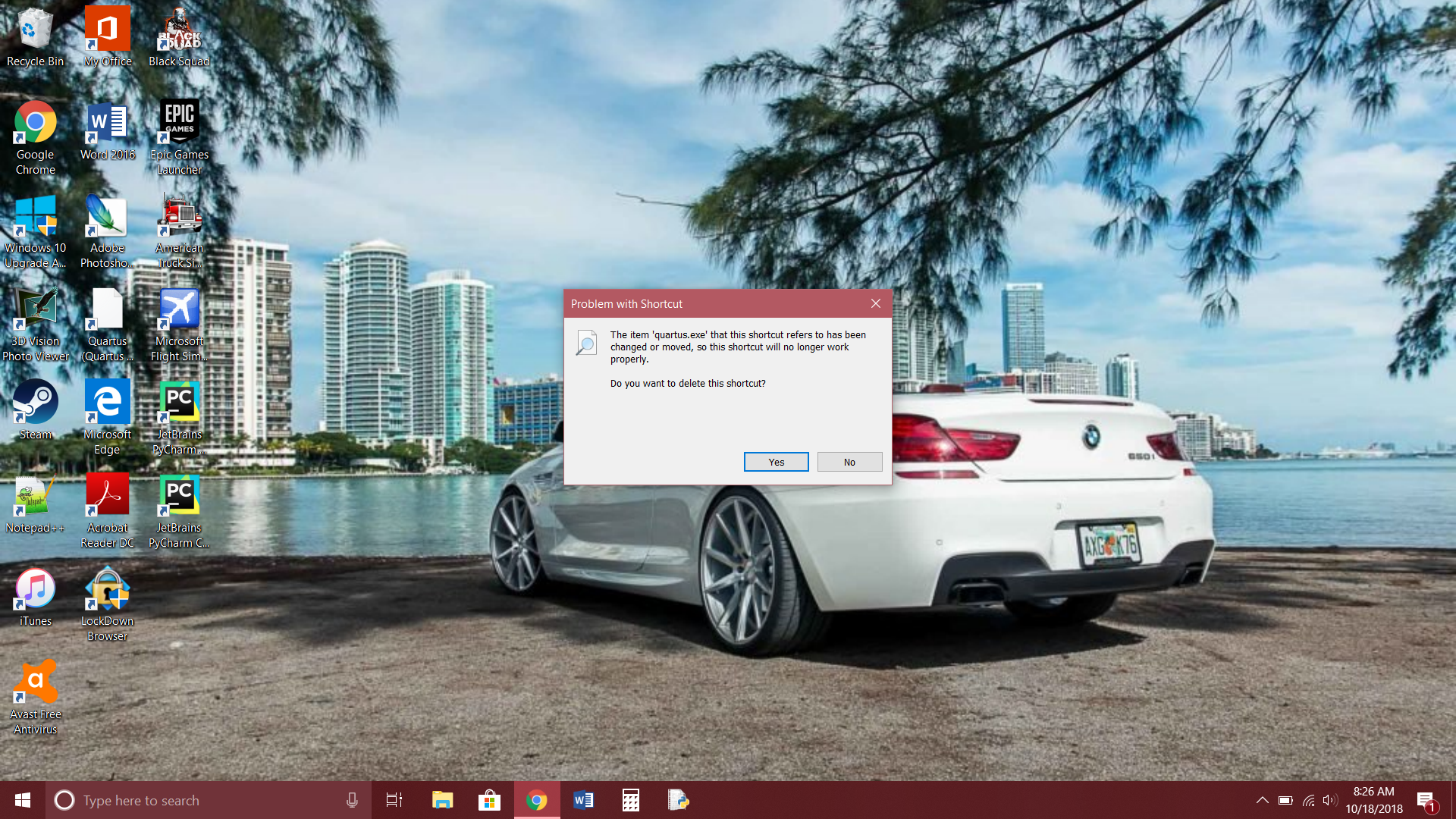

My Quartus Desktop Shortcut is not functioning properly, I have attached a screenshot of the error it's giving me. Can someone please give me assistance and or advice with this matter. Thanks in advance!
*Please attached screenshots

    1. Try to search Quartus lite 17.1 on 'Search windows' bar
    2. Right click ->' Open File Location'
    3. Here Copy the Quartus lite 17.1 shortcut & paste it on desktop
    4. if still have issue then need to reinstall the Quartus lite 17.1.

    It was working well for about two weeks, but now it is showing the error again. Is there a reason why it keeps corrupting the execution file and is there anything I can do to prevent it from happening? Reinstalling every week is not very practical.

    You might have an issue with the hard drive. Have you run any disk first aid? Or you could try installing Quartus on an external drive to test.

    Is it corrupted? Can you start it from a command line? TBH, it doesn't sound like a Quartus issue.​ It looks like a permission issue, or some kind IT override thing, which is messing with the permission/file.
