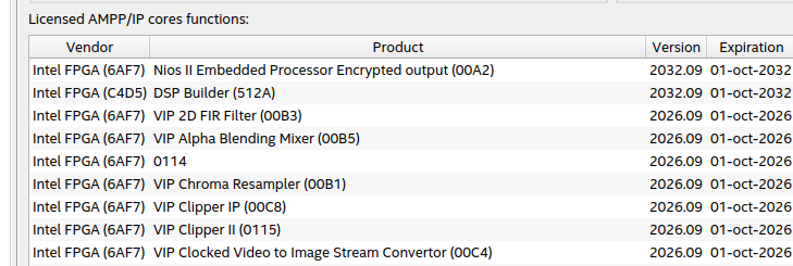

In Quartus, the products with the license are shown as below.. so I assume that I set the license properly.

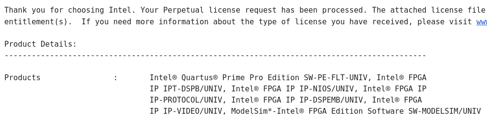

Below is the email that we receive for our purchase.
I assume that that the license for the ModelSim should be included
because "ModelSim-Intel ... " is included in the Products?
