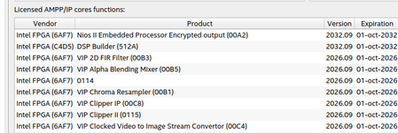

When I do
vsim
it says
Unable to checkout a license. Make sure your license file environment variable (SALT_LICENSE_SERVER, MGLS_LICENSE_FILE, LM_LICENSE_FILE)
is set correctly and then r...
- 3 years ago
I was able to resolve the issue by following this tutorial (https://www.youtube.com/watch?v=F6FvXga4f1A&ab_channel=ViljamsVidauskis).
I created a fixed license for the Questa-Intel FPGA Starter Edition and attached the path to the
License.dat file to my original LM_LICENSE_FILE.
