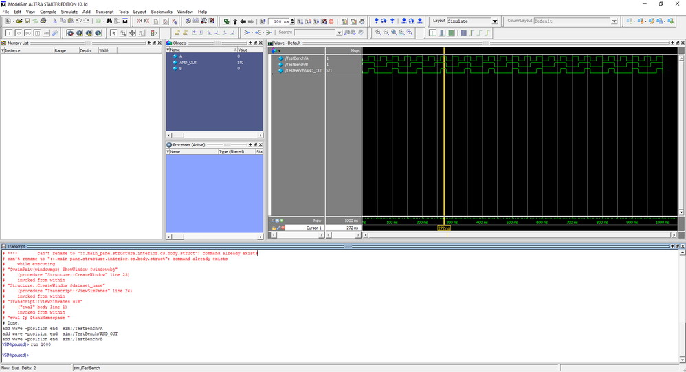

I have a problem with ModelSim Altera Starter Edition 10.1d (used with Quartus II 13.1). The project is based on Cyclone III, so I cannot use newer software. The problem started, when I moved the project to the newer computer with Win10. Reinstalation did not help.
I'm receiving following errors when trying to import design via tcl sript:
# **** Error: LoadCompleteQ cmd: Transcript::ViewSimPanes sim
# ****        ** Error: (vsim-4005) Invalid argument 'AssertionScope'.
# ContextView configure: -filter <filter-list>** Error: (vsim-4005) Invalid argument 'UPF'.
# ** Error: (vsim-4005) Invalid argument 'AssertionScope'.
#     while executing
# "Structure::CreateWindow $dataset_name"
#     (procedure "Transcript::ViewSimPanes" line 26)
#     invoked from within
# "Transcript::ViewSimPanes sim"
#     ("eval" body line 1)
# "eval $p $tankNamespace "
And
# ****        can't rename to "::.main_pane.structure.interior.cs.body.struct": command already exists
# can't rename to "::.main_pane.structure.interior.cs.body.struct": command already exists
#     while executing
# "$vsimPriv(windowmgr) ShowWindow $windowobj"
#     (procedure "Structure::CreateWindow" line 23)
The simulation is running, but I cannot see a project structure window.

    Hello Richard,
    Thank you for support. That was on revision: 2012.11. There is definitelly some compatibility problem, because I run the project with Modelsim Starter Edition 10.5b revision 2016.10 and it works perfectly.
    So my advice to other users would be to write a Cyclone III code in Quartus II 13.2 and test it in Modelsim 10.5b that is in a package with Quartus Prime.

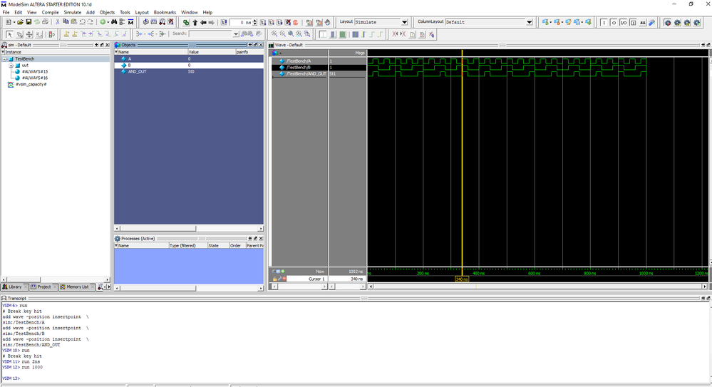

  • I am able to install ModelSim ALTERA STARTER EDITION 10.1d Revision: 2012.11 and run the simulation successfully.
    Below are the steps that I did.
    1. I just create a new project in Modelsim, added the Test_Project and the TestBench files that you provided.
    2. Compile both files.
    3. Run vsim -L altera_mf_ver TestBench -t ns
    4. Add wave and Run 2000
    I think this is mostly a bad installation but you mentioned you have try to reinstall before, so I am stumped as to why you are still facing this issue.
