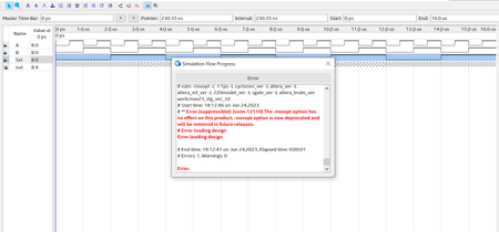

I have downloaded Quartus 20.1 version along with Modelsim and device. While I was trying to create University program VWF, I was getting the above error. It

As I downloaded Quartus II 13.0 web edition, I am able to create the webform. However, I have a new issue now. I have created a majority circuit ( output will be high if any two of three inputs are high).
This is what I am getting in response to the above input file.
If you look into the read only output file, you will see that it's remembering a previously created circuit (32bit adder). I tried all possible way to close that earlier project. Still it remembers that. Any suggestion?
- MR233 years ago
If I am using a different folder, it works just fine.
