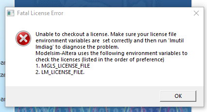

Modelsim-Altera editiob 10.1e (Quartus II, v14.0) not working
I installed Quartus II version 14.0 web edition for my university course. When I try to run Modelsim, I get a fatal license error
Please help

Hi ,
This error occurs may be because of ModelSim-Altera Edition license daemon is out-of-date please try to check after installing latest license daemon using link below,
https://www.intel.com/content/www/us/en/programmable/support/support-resources/knowledge-base/solutions/rd07172011_241.html
https://www.intel.com/content/www/us/en/programmable/support/support-resources/download/licensing/daemons.html
https://www.intel.com/content/dam/www/programmable/us/en/pdfs/literature/manual/quartus_install.pdf
Please check the below other solution as well.
https://www.intel.com/content/www/us/en/programmable/support/support-resources/knowledge-base/solutions/rd01122015_819.html
I would like to suggest, try to use latest Quartus tool(Quartus 18.1 lite is free).

- RAlex4
There are two files in the link given above, lic_daemon_win64.zip, Modelsim_Altera_daemon_win.zip. Which one should I install?
In the interim, I replaced the win32aloem folder in V14.0 with that in V18.0. Though it is working, I don't know if that is a good solution.

Install the Modelsim_Altera_daemon_win.zip & check.
'In the interim, I replaced the win32aloem folder in V14.0 with that in V18.0. Though it is working, I don't know if that is a good solution.' ---------- It`s not recommended way, better try to use modelSim available with latest version of Quartus.
