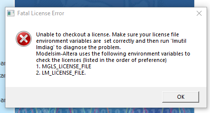

7 years agoModelsim-Altera editiob 10.1e (Quartus II, v14.0) not working
I installed Quartus II version 14.0 web edition for my university course. When I try to run Modelsim, I get a fatal license error Please help

7 years agoHi,
Install the Modelsim_Altera_daemon_win.zip & check.
'In the interim, I replaced the win32aloem folder in V14.0 with that in V18.0. Though it is working, I don't know if that is a good solution.' ---------- It`s not recommended way, better try to use modelSim available with latest version of Quartus.

6 years agoHi,
The website does not allow me to download Modelsim_Altera_daemon_win.zip. I get the following error
