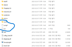

When you create a project, ModelSim automatically generates a work library, but in your case, it shows as empty even though you expect it to contain compiled files.
However, when you manually save and compile a source file into work, ModelSim recognizes it and allows simulation.
This means the library exists, but ModelSim’s project system isn’t linking to it properly.
