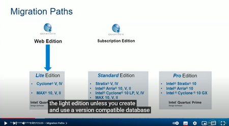

Hi I have a project written in Quartus II subscription version and I want to run it in Quartus 22.1 standard version. So I ran Quartus with .QDF file, and in the top left corner of the screen, it s...
- 3 years ago
Normally IP migration or device migration, from diff version or edition, sometime there will be an issue.
If the gap of the prior tool is big, better things to do is to instantiate directly the IP from catalog and compile.
Also, need to check as well the IP version, big gap might have issue (of course due to IP will keep updating for improvement and might be not fit with your design).
