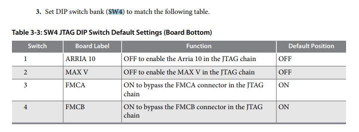

    Below are the suggestion workarounds you can try. You can try either one of these suggestion:
    1. Set your SW4 switch to default position setting. (refer to attachment picture)
    2. Set Switch 1 (MAX V) to ON position. Switch 1,3,4 set to default position setting. (refer to attachment picture)
    3. Changes your TCK frequency to 6 MHz (default value).
    I hope this will help.
    Thanks😉
