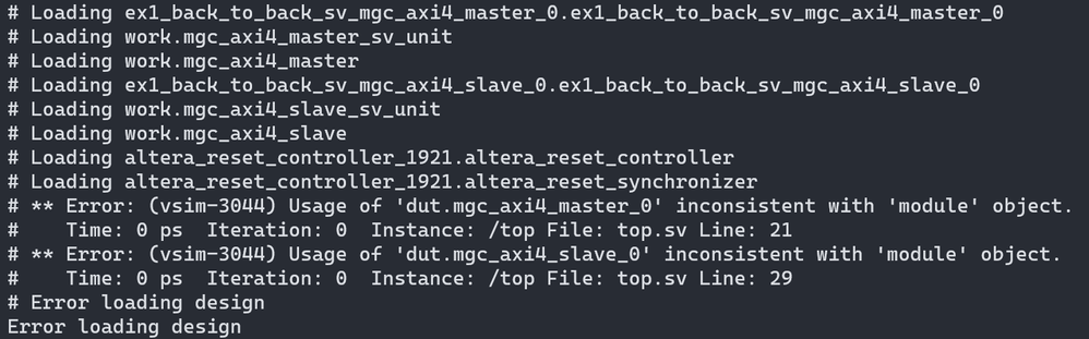

I got the following error:
It seems like that there is some issue with the provided testbench file top.sv. How could I resolve this error?

    I'm not sure what the -c switch does in your command line. You have to make sure to change the directory in ModelSim to point to the location of the simulation files. The guide has you do this in the GUI (page 681). Probably not the issue.
    What does the code in the generated top.sv file say at those lines?
