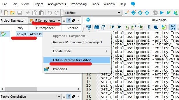

  • Vicky1's avatar
    Vicky1
    Please select the "IP Components" in Project Navigator & then open Parameter Editor as shown below(It will take few moments to open),
    Vicky
