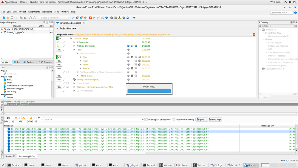

I am trying to add a very simple logic analyzer interface (LAI) to my design. Once I did this, then I restarted the compilation. But The compilation does not go through. Normally the compilation time for my designs is around 2 h. But now with the LAI after 09 h it still at the beginning of P&R (PLAN).
