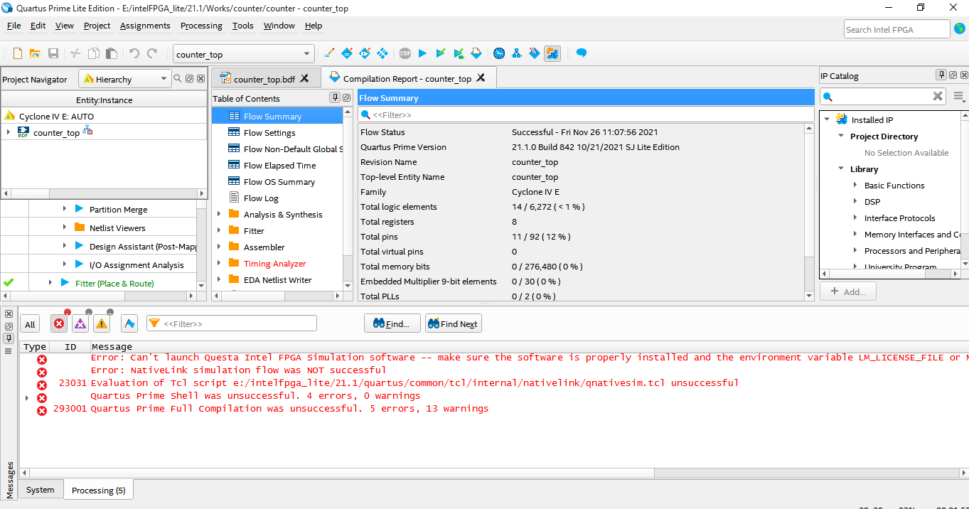

      So my issue is that I am not able to simulate.
      • Upon running compilation the following errors pop up.
      Error: Error: Can't launch Questa Intel FPGA Simulation software -- make sure the software is properly installed and the environment variable LM_LICENSE_FILE or MGLS_LICENSE_FILE points to the correct license file.
      Error: Error: NativeLink simulation flow was NOT successful
      Error (23031): Evaluation of Tcl script e:/intelfpga_lite/21.1/quartus/common/tcl/internal/nativelink/qnativesim.tcl unsuccessful
      Error: Quartus Prime Shell was unsuccessful. 4 errors, 0 warnings
      Error: Peak virtual memory: 633 megabytes
      Error: Processing ended: Fri Nov 26 11:08:05 2021
      Error: Elapsed time: 00:00:06
      Error: Total CPU time (on all processors): 00:00:02
      Error (293001): Quartus Prime Full Compilation was unsuccessful. 5 errors, 13 warnings

      • I figured there is some problem with the license and therefore tried to access the license self help center and got redirected to chat for associate partners of intel. Somebody called Twinkle in the chat raised a ticket for me regarding this and instructed me to follow up my query on this forum. So here I am.
      Kindly help me solve this issue. I am attaching screenshots of the above mentioned errors for you reference.

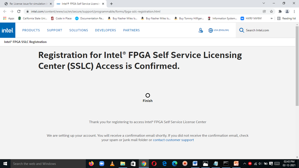

    As per your instruction I followed the following link:
    https://fpgasupport.intel.com/Licensing/license/index.html#
    and ended up on a page that just displayed
    • finish point for registration,
    • a link for reading full agreement
    • and a next button
    Upon clicking the next button, a message was displayed saying I would be sent an email for confirming registration. It is close to 10 hours since them and I have not received any link in my email yet.
    Upon following the above link now I am being redirected to partner alliance page. I have attached the screenshot of this page for you reference.
    Kindly help me out here.
    Thank you

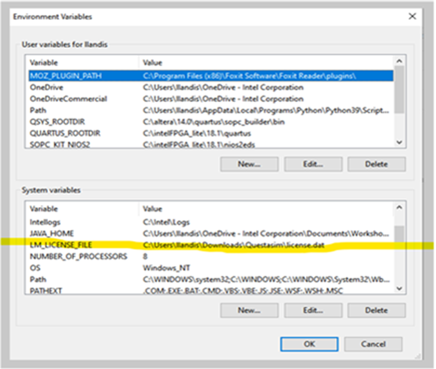

    • Lawrence_L_Intel's avatar
      Lawrence_L_Intel
      I'm an Intel employee and also teach at a local university and have had my students successfully download free Questasim licenses. send me an email with your 12 digit hex hostid (on Windows, command prompt: ipconfig /all and we'll get you the license. Sorry for the inconvenience.
      Larry
      [email protected]

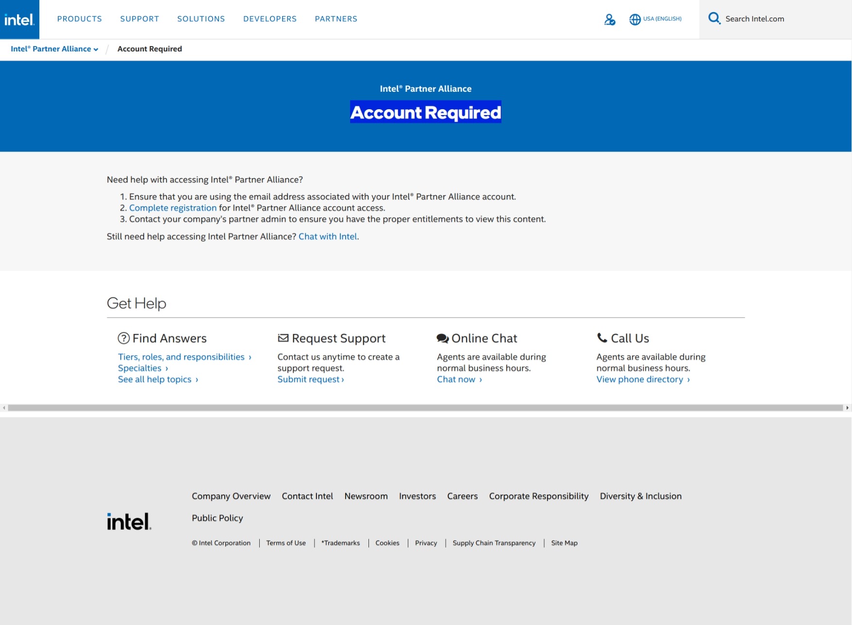

    • ifti's avatar
      ifti
      Hi, the link takes me to the Intel® Partner Alliance page. The page says Account Required. Clicking on the Complete Registration button does nothing. Can you please help me to get a license?
