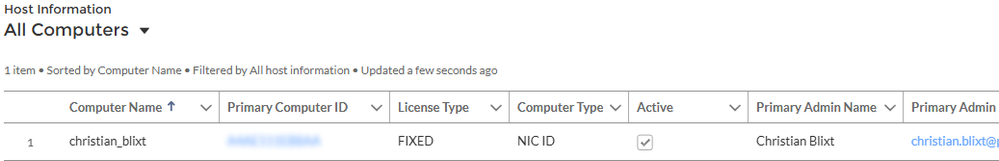

      Here is what I do. I have set up a computer, like so:
      The Primary Computer ID matches the NIC ID of the computer I want to use the license on.

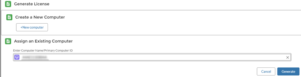

      Next, I go to Find and Generate License by Activation Code, enter the activation code from above and click Search, select the license that appears and click Next, then I arrive at this:
      Where I, after confirming that the existing computer is the right one, click Generate. Then it says that my license file has been generated and will be emailed to me shortly. Short thereafter I get an email with an attached license file (I'm up to four attempts now), but both the email and license file are blank in the Host Type/Primary Machine ID sections as shown above.
