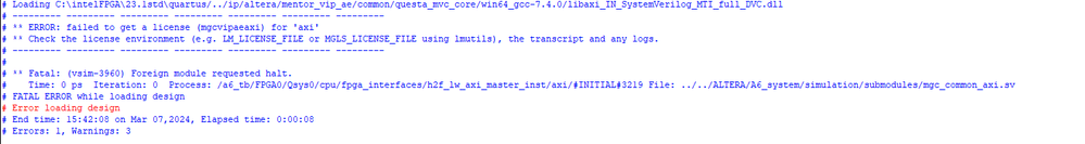

When I try to run a simulation for Cyclone V with HPS, I get this error :
# ** ERROR: failed to get a license (mgcvipaeaxi) for 'axi'
# ** Check the license environment (e.g. LM_LICENSE_FILE or MGLS_LICENSE_FILE using lmutils), the transcript and any logs.

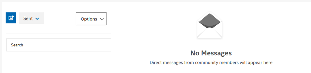

I cannot send private message because I have reached the limit, even though this is the first message I try to send...
Edit : finally I managed to send it.
