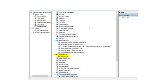

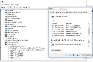

Hi guys. So I have Quartus Prime Lite installed, but I think I missed one thing. I am not able to connect my Max10 Neek development board to communicate via on-board USB-Blaster II. When I first connected the board, I did Not find the drivers manually, as i'm now clear on, and as a result a 'uart/USB driver was found automatically. So now I would like to know the steps I should take to remedy the situation. I have tried going to the USC devices and uninstalling the driver but now it just comes back when I connect USB-Blaster II again, rather than asking for drivers instructions.
I have also read on other threads that I will need to in-install Quartus and try again. True?
Will re-installing fully remove this wrong driver? Thanks for your help.
