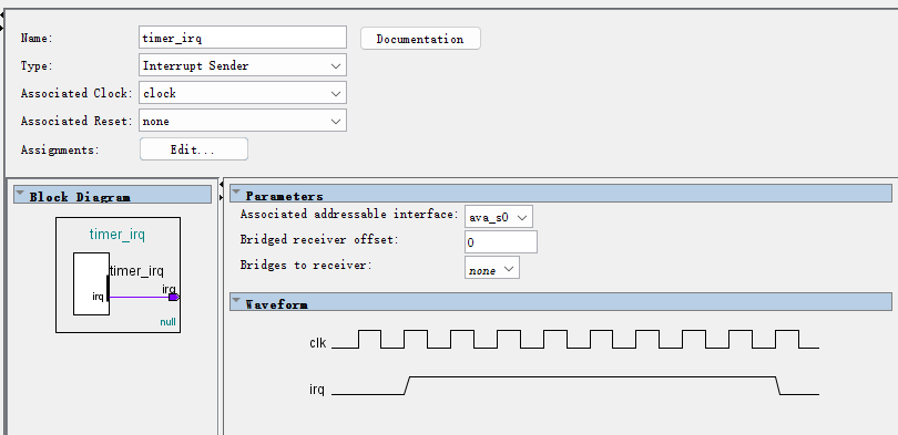

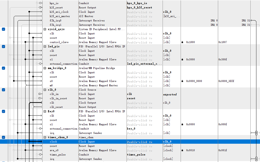

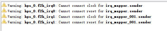

I wrote a personal IP which will send IRQ to HPS(Liunx) in some situation.
I'm planning to write the LKM to use that IRQ.
But parameter setting confused me a lot.
Could you guys explain the IRQ sender settings for me?
What are they? How they should be set to what purpose?
Why there is the clock and reset selection, what's the purpose of that?
Where can I find these setting information?
