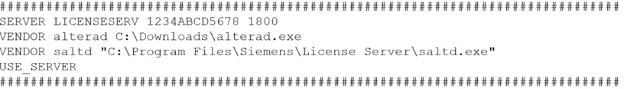

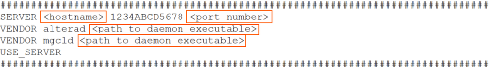

License configuration details below:
SERVER xxxxxxxx xxxxxxx 27000
#SERVER <hostname> 0050568F1133<port number>
DAEMON alterad C:\Flexlm\Maxplus\alterad.exe -port=27001 please follow this Know-How: Set Up a Floating License (Step-by‑Step Walkthrough) | Altera Community - 352000 step 2 format:
this line DAEMON alterad C:\Flexlm\Maxplus\alterad.exe -port=27001 seen weird. Port number can use random number not repeat with your pc port number. I suggest using 8888
