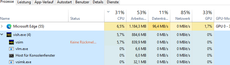

Intel Questasim is very slow for changing directory & compiling
I have a similar problem to this: https://community.intel.com/t5/Intel-Quartus-Prime-Software/Intel-Questasim-is-very-slow-e-g-cd/m-p/1452108
The Simulation runs very fast, but every time I change directory (regardless what's in it) questa gets stuck for no reason and also with no significant load:
Other commands which interact with the filesystem, e.g. "dir" run fast.
Same happens when I compile any VHDL file. The compilation itself runs fast but Questa freezes for several seconds before compiling every single file and also after the compilation is complete (in transcript window).
The delay and freezes do not differ between Start and full FPGA Edition. Im using a full license for FPGA Edition.
