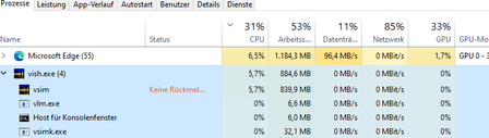

1 year agoIntel Questasim is very slow for changing directory & compiling
I have a similar problem to this: https://community.intel.com/t5/Intel-Quartus-Prime-Software/Intel-Questasim-is-very-slow-e-g-cd/m-p/1452108 The Simulation runs very fast, but every time I change d...
FabianL
11 months agoHello Richard,
- I have the same situation with both Pro & Standard bundled Questa versions
- 40 seconds for changing a directory is exactly what I mean, that this is not what it should take. I have a high performance workstation with i9 13th generation, my directory switching time is a bit shorter, but I guess changing a directory or reading an .ini File should be a top notch task for a workstation like this.
- Especially since it was much faster in previous version (Questa 2021). I have attached measurements for Questa 2021 & Questa 2025 with a .do file for reproducing the results. (log_Questa_2025.1.txt vs log_Questa_2021.1.txt )
- I also have significant delays after compiling files and starting simulation. I created a sample project (questa_test.zip) with a compile script which logs the timestamps after compilation and before/after simulation. For Questa 2025.1 the time after compilation before starting simulation nearly doubled! compile_log_Questa_2025.1.txt vs compile_log_Questa_2021.1.txt
I hope this helps to reproduce the issue on your side.
By the way restarting my computer or switching to other computers does not alter the problem.
