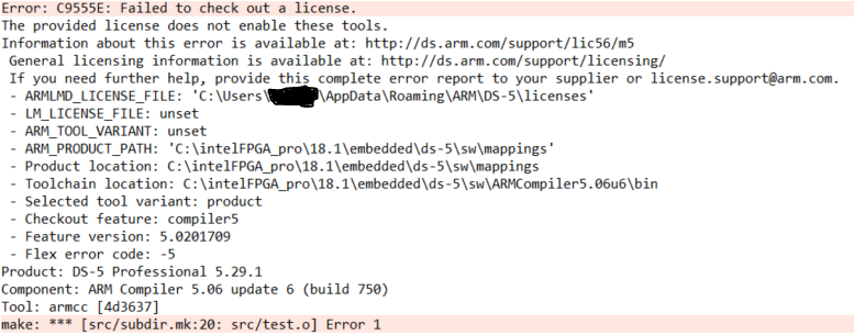

Hello, I am having an issue with my license not being read/checked out. I made sure the license was registered and hosted with the correct NIC ID. Below if a screenshot of the error message. Any help would be appreciated.

As I understand it, both Quartus and ARM require valid licenses. For the ARM license, you will need to use the DS-5 license manager or visit the ARM website at https://silver.arm.com/ to register. You can refer to the ARM user guide for more details: https://www.rocketboards.org/foswiki/Documentation/GettingADS5License?elq_cid=5630050_ts1718354134384

I followed those steps and still the same issue.

Could you request / re-generate again new license .dat file for both both Quartus and ARM and try it again.
Self Service Licensing Center. https://licensing.intel.com/psg/s/
For Quartus Guidance:
