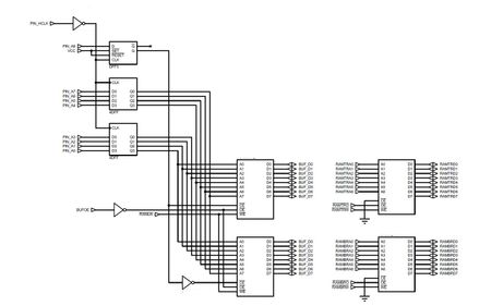

Hi all, this is my first post here, very happy and excited to be part of this community I'm doing my first FPGA project with a MAX10M08SCE144C8G device, since I'm not (yet) familiar with HDL (Veril...

1 year agoHi,
main problem in emulating static RAM isn't the bidirectional data bus, it's the fact that FPGA block RAM is synchronous, it uses a clock, at least all inputs (address, data, WE) are registered. This allows faster operation than asynchronous RAM, but external logic will look different.
As you already mentioned, there's no bidirectional bus inside the FPGA, but it can be emulated if it serves a purpose. External I/O pins can of course implement bidirectional I/O with tri-state, similar to discussed RAM.
