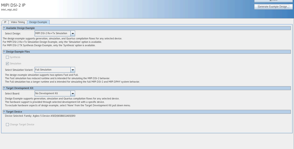

Please refer to my .ip setting below. I try it and it is success.
Please ensure that you had run the "Analysis & Synthesis" before running the simulation

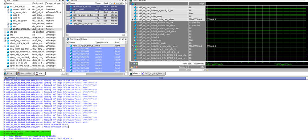

Locate your directory under ../x/../ed_sim/sim/mentor
- vsim &
- do msim_setup.tcl
- ld_debug - add wave from the left side
- run -all
I can get my simulation PASS
Let me know if you still unable to do it.
Wincent
The simulation with default video timing looked great to me - it looks very solid. No issue with the simulation - it looks much better in the design example from Quartus 25.3. It is a very long sim so I didn't run to completion - I stopped it after about 1/2 hour but it looks very good.

First
I tested the following configuration for 800x96 only, and it passed the simulation successfully.
It is configured as close as possible for simulation purposes.
Due to a limitation I discovered — the frame height in the simulation is fixed at 96 — it effectively simulates a resolution of 800x96.
The only change you’ll need to make for your final hardware system is to change `C_TIM_VTOTAL` to `630` to update the active height to `600`.
(Note: this change will not pass simulation due to the limitation in the simulation components.)You may follow the `.ip` settings below to try it out.
For the simulation variant, you can select either *fast sim* or *full sim*, depending on your needs.Second
