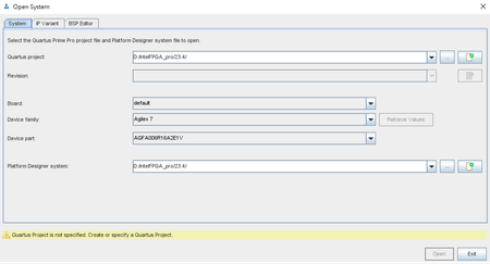

2 years agoI can not open platform designer (23.4 pro edition)
When I try to open the platform diesnnger I face the problems. I screenshot these infomormation. 1.Quartus Project is not specified. Create or specify a Quartus Project. 2.IP file not specified. ...
ShengN_altera
2 years agoHi,
Under System tab, Platform Designer System: click 3 dots and select the .qsys file then Open.
Sheng
- TakaU2 years ago
I have a same problem.
After the third picture is displayed, the only way to exit is to select 'exit'.
However, the Platform Designer System disappears,making it impossible to select the 'system' tab.Any idea to setup project or Quartus ?
