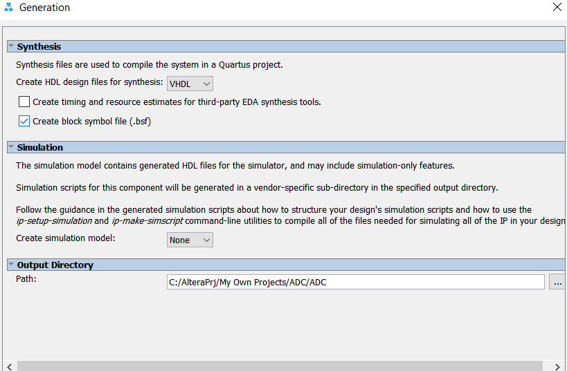

and how do I see that instantiation template?? because when I click on HDL generates, it shows me this

At the end, I was able to find how to call the instantiation into my Top level entity. Thank you!

Platform Designer Generate menu -> Show Instantiation Template

In PD menu --> generate --> show instantiation templates.
