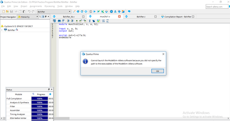

How to specify a path to the executables of the ModelSim-Altera software?
- 6 years ago
Go to Tools > Options > EDA Tool Options.
Check that the path to the ModelSim-Altera software is correctly set to: <install_directory>\win32aloem (for example, C:\intelFPGA\18.1\modelsim_ae\win32aloem)
