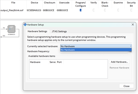

3 years agoHow to install USB Blaster ii drivers for Parallels 18 (Windows 11) running on MacBook M1?
I am working with the DE10 Nano kit for my current project. I have installed Quartus Prime Lite Edition (22.1std.0.915) inside Parallel Desktop 18 (Win 11) running on MacBook M1 (Ventura). I could c...

twister1398
2 years agoHi,
it is stated quite clearly that they are using the DE10 Nano kit which is equipped with an on-board USB Blaster II.
They also state that a corresponding driver for the ARM64 platform is missing and that the supplied USB Blaster driver is incompatible and therefore refused by windows.
It would be welcomed by a large part of the community if Intel could commit to providing a compatible driver for ARM64 platforms.
