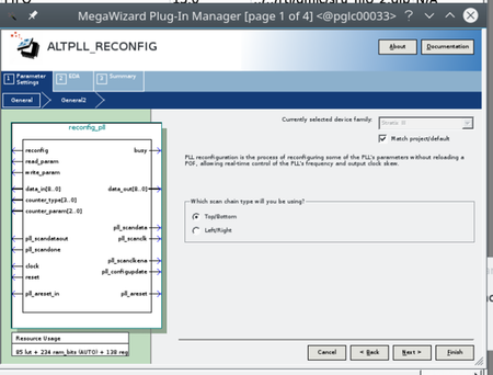

4 years agoHow to generate reconfig for S10 ?
HI,
This reconfig from ver 13.x
now I want to generate at 21.x
which has like this
module reconfig_pll_pllrcfg_vvr ( busy, clock, counter_param, counter_type, data_in, data...
minjoolee
4 years agoother about from ALTPLL to IOPLL intel FPGA IP.
this one from ATL_RECONFIG to IOPLL Reconfig Intel FPGA IP.
Re-generation ok, but I will don't know how to .
There are too many port changed and
pll_scanclk,
pll_scanclkena,
pll_scandata,
pll_scandataout,
pll_scandone,
can't see in 21.x
also old one doesn't require *.mif but in21.x is required .
My old project can synthesis without error , it means that I was not need *.mif
1) *.mif
how to make for replacement of old ip from 13.x
2) port missing
so many port are not shown in 21.x. how to generate in 21.x ,
Let me get right way
