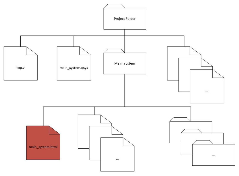

When you open top level project folder, with qsys in it (we have top level entity as wrapper for QSYS now) you have folder named same as your top level QSYS. See pic below and it contain information about qsys components like parameters, sw dependencies, connection, base addresses... Question is how to set those parameters cause this documentation looks usable...

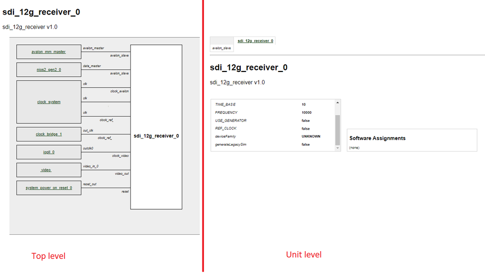

Iam looking for description how to pass those parameters to this file. IE component itself is well structured, you can find even few comments in its description but in top level qsys file there is much less informations, see pic below
not only missing parameters but also others can be passed to top level file, you already generate this so how can I pass more inside ?

As you can see on right picture - Unit level - there is description. Just parameters but at least something. I want to add more information there, humble wish is component description in text form, true wish would be pasting images and comment also ports/interfaces
At the end connecting this HTML tree together and use hyperlinks between unit and top would be really nice!
