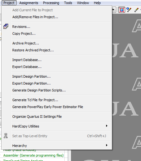

      There is no option as clean project in the Quartus II software. Here is the screenshot of the project menu options. Can you help me to find out?
  • KennyT_altera's avatar
    KennyT_altera
    Seems like you are using the old version of Quartus. This feature is not implemented there yet. Can you use the latest release of Quartus Prime?
  • sstrell's avatar
    sstrell
    Quit Quartus and delete the db and incremental_db folders. It does basically the same thing.
