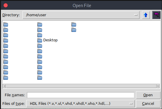

Hello, I have been trying to get modelsim to work on my linux computer, but the modelsim is laggy and the fonts won't display correctly.
I'm using a Debian based distro. I wonder if there is any way to change this file browser to something else. Or if there is a way to fix this.

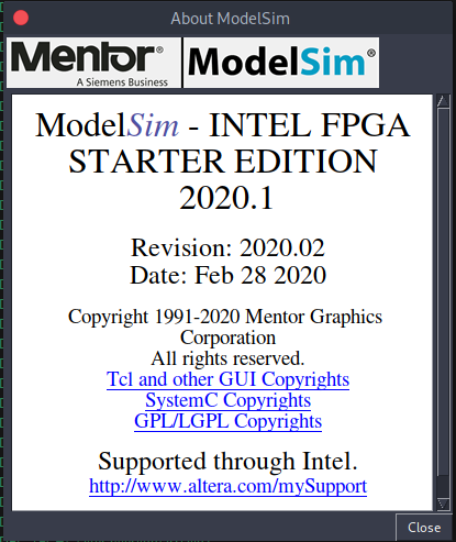

    2. Which version of ModelSim are you using?

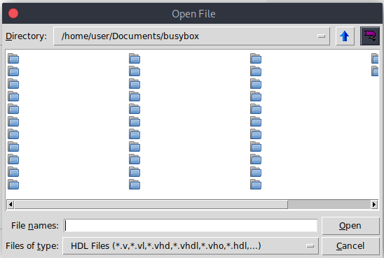

      Hi, This issue only occurs with the File Manager. I'm using this version of Modelsim.
      Even tho I can't see the font on the files. If I click on one of the folder, it refreshes and show the name for that folder. It's a weird bug tbh.
      I'm having issues only with the file manager.
