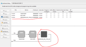

I still have one more question. I am using quartus prime 24.2 linux version now.
we have 2 types boards, type 1 only has A10 in the jtag chain and type 2 has A10 and another unknown device in the chain as i mentioned previously.
with your solution, the type 2 can always works in GUI. and i saved the jtag chain setting to a file named phoenix_FPGA_top_x4.cdf.
as below figure shows. Genesis is the name of the unknow device.
we have more type 2 boards to be programmed so we would likt to use the command line to program them.
with below command being put into a TCL script named jicdownloadnew.tcl, I can always run it on type 1 board.
qexec "quartus_pgm -c 1 -m jtag $currentDir/phoenix_FPGA_top_x4.cdf"
but on type 2 board, it will always fail with below error information.
but i found if i firstly open the GUI programmer with setting in phoenix_FPGA_top_x4.cdf, and let the programmer keep idle on the back-end, then run the TCL script in the shell, the script will always be sucessful to program the type 2 boards.
so i doubt when i open the GUI programmer, the programmer should do some set up operation for the jtag chain, when i run the script , it can support the GENESIS device. if run the script without openning the GUI programmer, below error will be reported.
Error (210009): Device GENESIS is not supported
Error (23028): Unknown argument "/home/rain/myfolder/phoenix_FPGA_project/01_project/02_config_files/phoenix_FPGA_top_x4.cdf". Refer to --help for legal arguments.
how can know the setting and so I can add them into my script, thus i can run the script without openning the GUI programmer firslty.
thanks in advance.
rain
