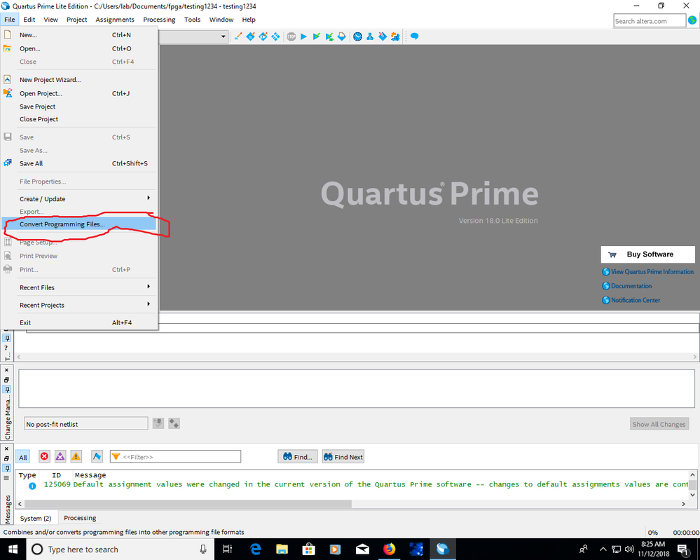

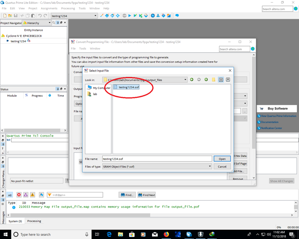

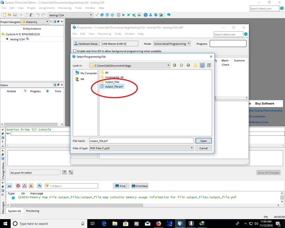

    In Quartus, click File->Convert Programming File. This tool will allow you to re-target your .sof file (which programs the FPGA) to a .pof file (which will program the flash memory). Once you've created the .pof file, just use it in the Programmer like you currently use the .sof.

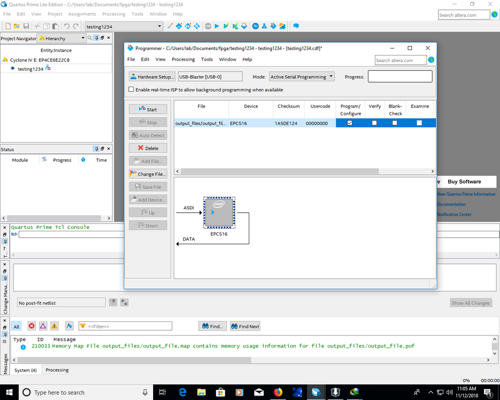

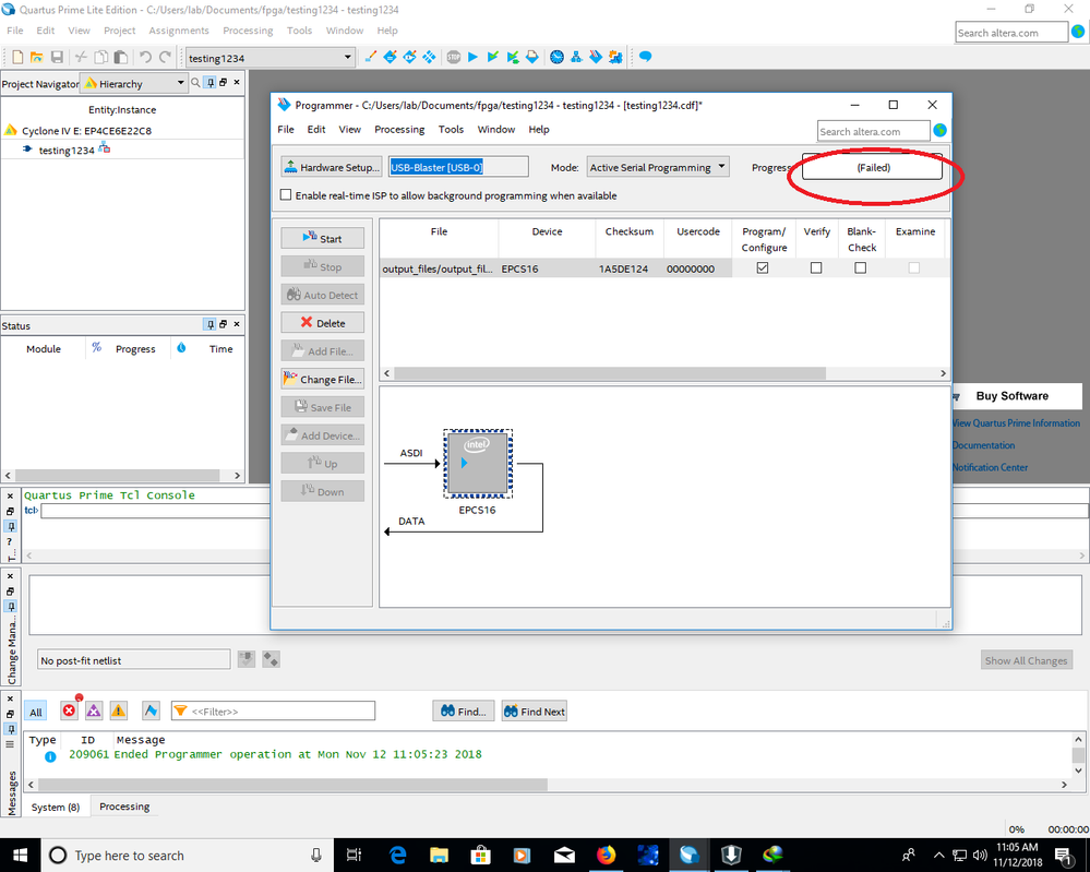

    Hello Andy, I tried your procedure but it throw me "fail" when trying to upload the code on the board. I have attach a screenshot of what I did.
  • AndyN's avatar
    AndyN
    I'm afraid I'm not actually familiar with the specific board / flash device you are using so there's not too much more I can suggest here. Are you sure you've definitely used the correct device type in the tool and that Active Serial is the correct mode?
    Did the tool give any actual warnings/errors apart from the "Failed"?
