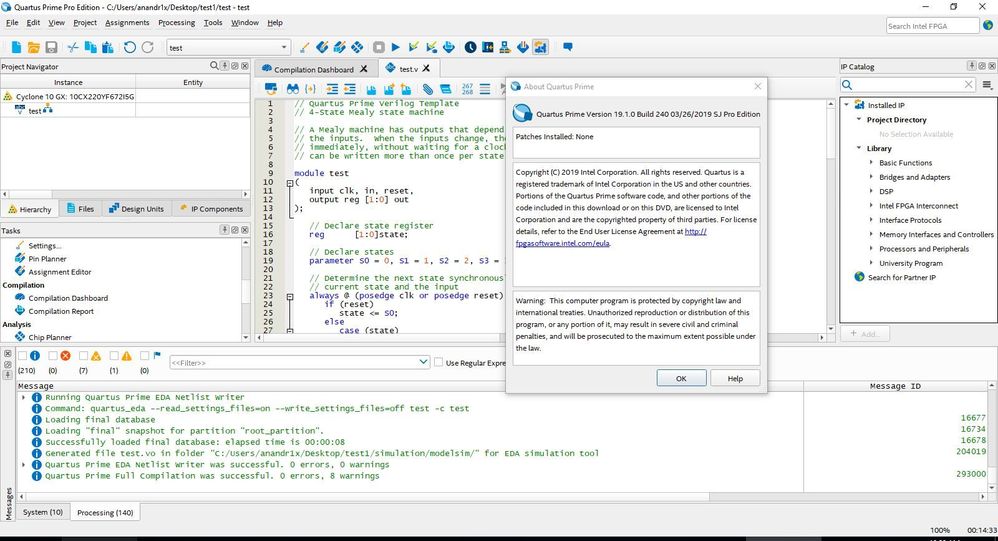

  • Hi Nanjunda,
    Is your dll issue solved by reinstalling? I have installed the Quietus 19.1 pro on windows 10.i did not face any issue.
    Regarding driver installation it may fail if the required driver already installed try by manually installing.
    Attached the image
    Anand
