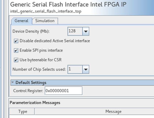

    Do check out this link to enable the GSFI HAL API: https://www.intel.com/content/www/us/en/docs/programmable/683419/21-2-20-1-1/nios-ii-hal-driver.html
    You will need to Enable altera_safeclib in BSP Software Package from BSP Editor to use the HAL API.
    1.To enable the altera_safeclib, these are the GSFI IP parameters that you will need to set with the photo attached below.
    2.Regenerate the .sopcinfo file and you should be able to see the altera_safeclib on the software package.
    Thank you.

    • KellyJialin_Goh's avatar
      KellyJialin_Goh
      Here is the parameters that you will need to set for the GSFI IP to allow the altera_safeclib.
      Thank you.
      Kelly
