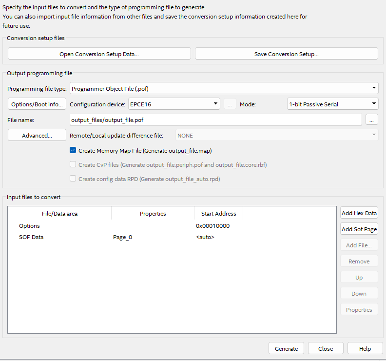

  • Thank you Frank.  That checkbox is grayed out for me:
    Do you know any way to enable that?

    Hi Dennis,
    you select .pof format for internal configuration and enable additional .rpd generation. .rpd is the binary format that can be written to internal MAX10 flash with On-Chip Flash IP. It's basically possible to extract CFM binary data from .pof file, but as you say, format is undocumented.
