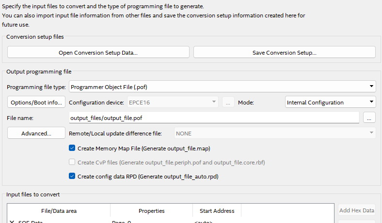

5 months agoGenerating RBF raw binary file on Max 10
I am trying to design an in-system firmware update for the Max 10 FPGA. I have a microcontroller between the FPGA and the outside world. The microcontroller has a large data storage area where I wa...

Hi Dennis,
it's wrong .pof mode. Must be Internal configuration rather than PS.
Regards Frank
Dennis_Nedry
5 months agoThat worked thanks!
I was also able to do this from the command prompt like this:
quartus_cpf.exe -c -o auto_create_rpd=on firmware.sof firmware.pof
This generates all POF and RPD files from the SOF file.
