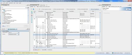

6 years agoHi el.ign,
Thank for the help.
The project is for an Arria 10.
I have follow your instructions. I have created an INI file (quartus.ini) and I have added it to project via Settings dialog box.
In this file I paste your instruction, and I rerun the entire compilation project.
Unfortunately, the same error is raising during compilation.
Could you confirm the correct implementation of this option ?
