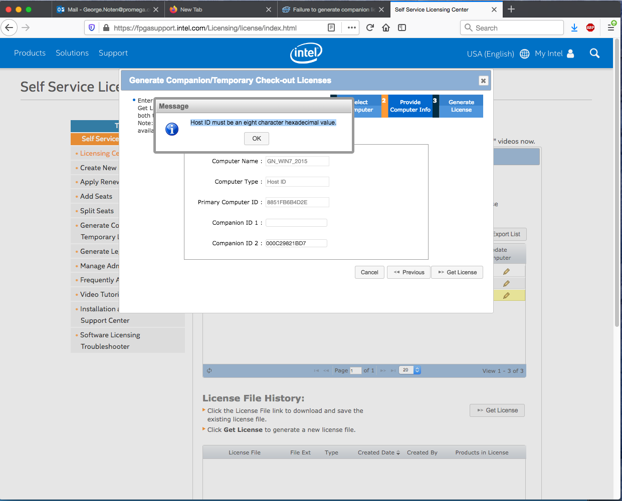

I am trying to generate a companion license for my home computer by opening the window "Generate Companion/Temporary Check-out Licenses". However, every time the hostid in the generated license file points to my primary computer, not the companion ID specified on the web page.

I did it several times. Every time I get a license file for the primary computer, not the companion license (my primary computer has 2 companion IDs ).

I never use more than one computer at a time because all of them are in different locations. Unfortunately, generating a companion license for my home computer is not possible. No matter what I do, the license is generated for the primary computer only.

- AR_A_Intel
Hi Sir
Our customer service team has reset your license. Could you help to re-generate companion license and run the simulator again.
